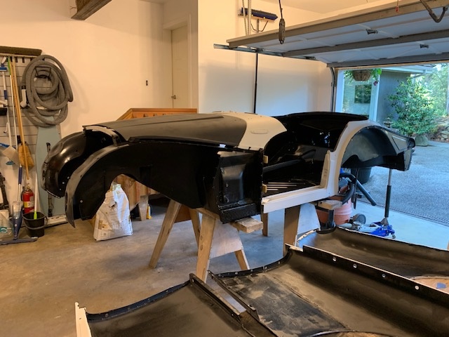

Hi guys,
Just looking into getting some advice here. Maybe even talk me off the ledge.
I've been working on my TR3 body now for 8 months. I have the body off the frame and I've got all the rust areas fixed, used body filler and epoxy primer to seal every inch of bare metal. I had it sand blasted to bare metal before doing the repairs. I'm at a cross-roads now and wondered if you guys have insights as to whether or not I paint the car myself? Or, have a professional do it. I'm going with black - a solid color so don't need anything fancy although Black will show everything. I don't have a paint booth or a large volume air compressor. I suppose I could invest in a decent compressor but honestly don't want to spend a ton of money on the size it would require for a HVLP gun. I've seen some guys use a LVLP gun and maybe that is a work-around for using a smaller compressor (20 gal or greater). I'm perfectly happy to add the build primer and get'r smooth and ready for paint myself (and take as long as it takes to get it "perfect").
You guys have any personal stories you'd like to share to say - Ya! go for it. In the end you can say I did the whole car myself! Or.... better to have an end result you can live with by having someone spray the car for me. Pros and cons to each I'm sure.
Let me know!
Joel

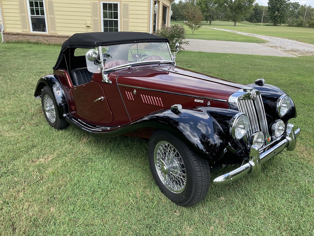

I did all the work on my numbers matching TF with the exception of chroming and painting it. Took all the pieces and had a friend who owns a custom car shop and he painted everything with the exception of the chassis and drive train plus engine, I sprayed those myself. Putting everything back together was nerve-wracking, to say the least! My wife was a big help holding sheet metal pieces while I bolted them in place! Gotta love that girl! :devilgrin: PJ

Looks beautiful!! Holy smokes that looks good...
So, judging from this I'd say your vote is to have an expert paint it. If it looks that good - I'm in.

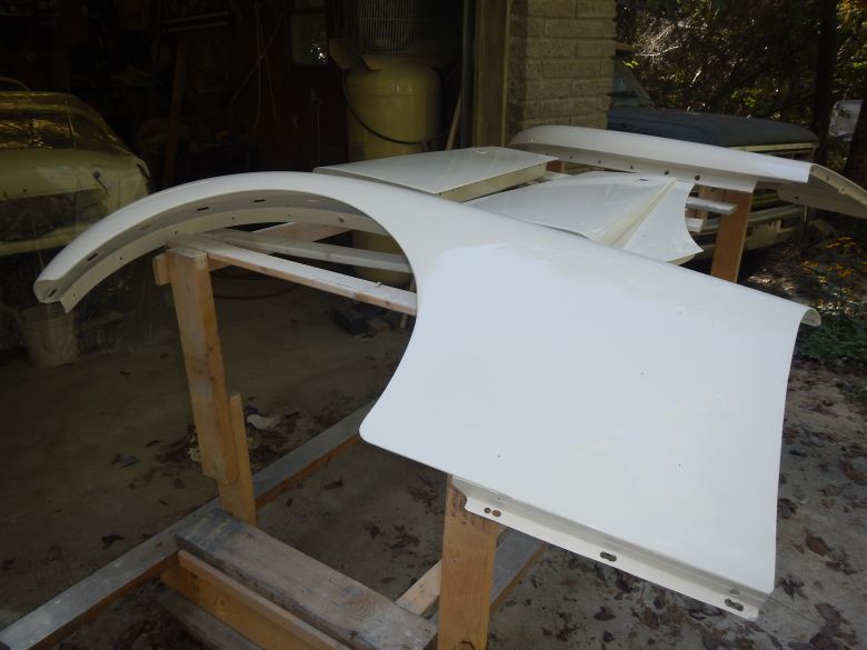

I painted my TR3 my self never having spray painted anything before. I went with off white and it turned out well. Doing it yourself you can do each panel separately so you get both sides and the seams. I think most shops will want it all together. A friend has his painted at a local shop that he knows and he gets it done panel at a time.
Good luck.
David

I agree with David on painting the car in pieces, everything on my car was painted that way, no bare metal or primer showing anywhere, just paint. (y)

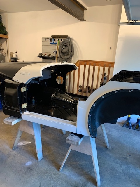

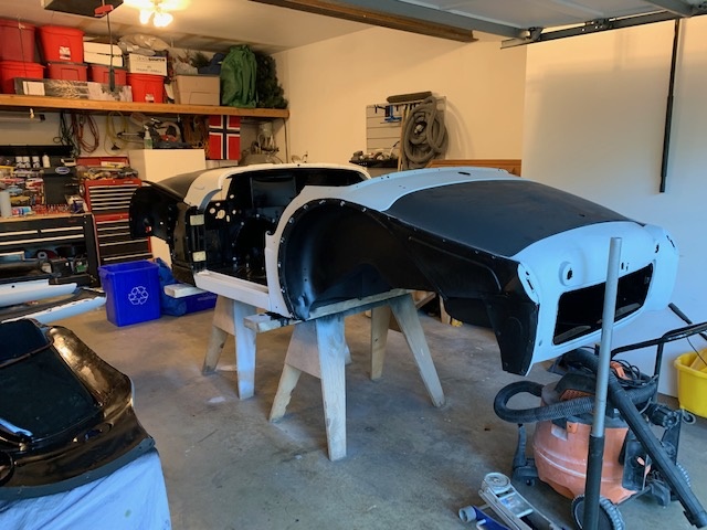

Thanks guys. All good advice here and in-line with what is going through my head. I'm going to do all the prep work myself with teh build primer, work my way up the grits and likely take it to a guy in my local car club. I was able to get a few names to reach out to. Regarding black... I know it will show any little imperfection but on the other hand it's been nice to be able to paint the engine bay, wheel wells under body black.

I notice that your tub does not have braces in the door openings. Braces are a good idea when you lift the tub off the frame to add rigidity to the tub.
Nice shop with plenty of space.
