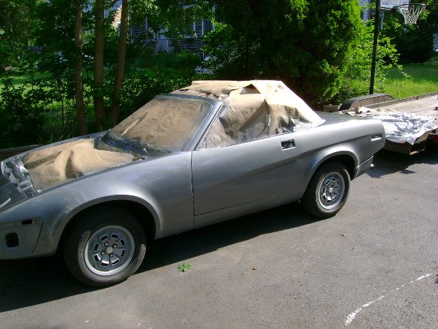

The paint looks silver in the bright sun. In the shade it's more of an anthracite. It is called space grey metallic. This pic was taken while I was cleaning up before the paint had flashed. Didn't take a pic of the bug tracks, but I will when I get back to it. Spending the weekend working on all of the black trim pieces and rockers in between the thunderstorms.

BMW space grey is a really nice color, wedge lines will look good in that color (like you need me to tell you that).
I dig it.

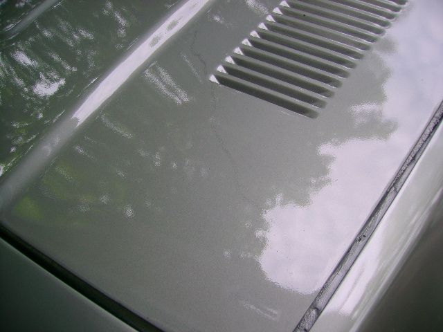

That is too funny. Sounds like my neighbors house. Prime hunting grounds for my cats. I just wish they wouldn't keep leaving dead chipmunks for me to find. Here is a pick of the bug tracks. I tried wet sanding them out. No luck. This paint won't take to wet sanding. It looks like the black metallic floats to the top while the paint is drying. Wet sanding just gives it a marble effect. I'll have to respray the nose and then hit the whole car with some clear that I can wet sand to get the good shine.
