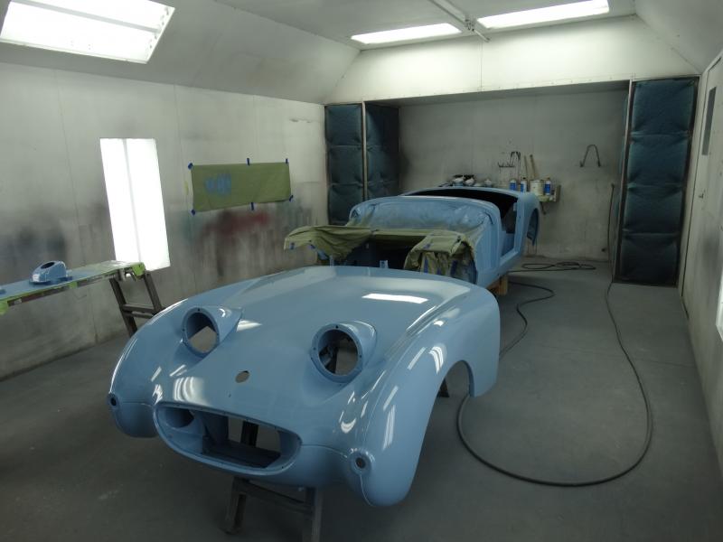

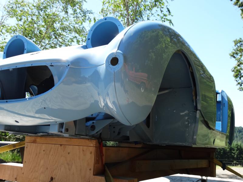

I want to give encouragement to all of you that have considered painting their car themselves. It's not that hard to do once you build up the confidence and of course you have the pride of knowing that you did it yourself.
The last time I painted a car was 30 years ago with Glasurit hand brush enamel, sprayed from a gun. I didn't know what I was doing then, maybe still don't, but I did more research this time.
The tub was completely stripped down, the bed liner that the DPO applied to the engine bay was removed with a heat gun and scraper and then media blasted. There were only two small rust spots that needed repairing and it still has the original floors.
When I purchased the car it was painted white, but I decided to take it back to its original Iris Blue. I sprayed the primer in my shop and then rented a spray booth for the top coat. It turned out well and I'm real chuffed with the results.
I used Kustom Shop DTM primer sealer from TCP Global (almost a gal.) followed by PPG Concept DCC single stage (3/4 gal.). The PPG was mixed to match an existing piece of the original body that was still in Iris Blue by the local paint store (Industrial Finishes).
Dave

Nice job. How much did it cost to rent the paint booth?
I have been using the TCP paints recently and found them to be quite good. My only complaint is the shipping charge to the east coast... but that's not TCP's fault. I also like the DCC paint from PPG. I found it sprayed really well and buffed up to a nice shine. One suggestion the local PPG rep gave to me was to spray the final top coat as a 50/50 mix of the color coat and their DCU clear coat. The result is a deeper gloss than the single stage color coat alone provides.

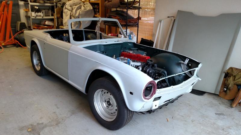

Painted mine in the carport with snow on the ground before and in the new garage the second redo... If you can do prep work, the. The painting part is easy day.

The paint booth cost $150 for the day (8:00am to 8:00am the next day) and the owner does all the cleaning so all you need to do is turn up and paint. He also has a great air system with a chiller. My son suggested mixing with the clear with the final coat but as this was basically my first paint job I tried to keep it simple.

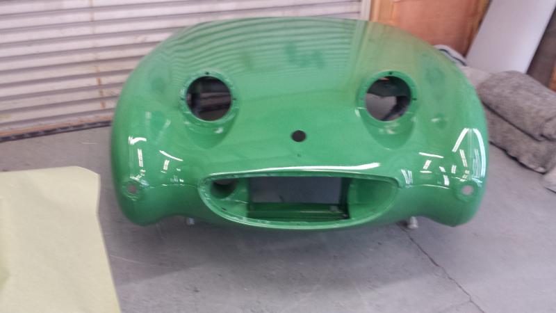

Nice Job! i painted mine myself with TCP global paint as well last summer. i think that stuff is well worth the money! it's probably not as durable as DCC, but 1/4 the cost. it took one gallon to do the whole car including the underside of the tub, the inside of the bonnet and the cockpit. I'm building a 24 X 36 X 9 garage in the backyard this summer to facilitate more home paint jobs:smile:. i've got an itch to rebuild a triumph GT6 Mk1 next.

I probably wouldn't try to paint a metallic first go... But it's not to hard to paint normal colors just take your time. It's all in the prep work. I use the Eastwood paint and it works great, plus it's cheap. Painted 2 cars with it now, both a red and black and Id recommend them for the do it yourselfer

If you would like to learn, your local community college may be a good choice. I took a number of classes at Contra Costa College in San Pablo, CA and learned a world of stuff about body repair, welding, and painting. Next job, painting the TR6 british racing green.

that is leaf green from the 1958 AH/MG color chip card on TCPGlobal.com. those color chip cards are supposed to be original.
Nice looking green. What did the first coat cover like?
I wonder what the Iris Blue from TCP Global would look like compared to the match to the old Iris Blue I found on my car?
The red '59 Bugeye I have was originally Iris Blue as well. I would like to try the paint from TCP Global, but not sure that I want another Iris Blue

it covered well. like i said, i like the paint for the price. the durability still remains to be seen though. if it fades or chips unreasonably i guess i would repaint the outer body panels with DCC. by going through TCP i was able to take advantage of them having the color chips to work from as well. i couldn't find any formula codes that were still valid for PPG.
