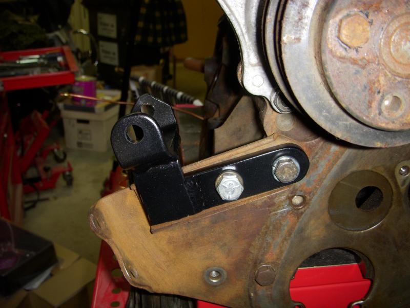

attachment.php
I have the Delco in the Bugeye. Not the easiest to mount but cheep any where. After building a mount it only takes about 10 min. to replace.
