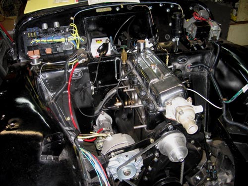

I installed the Delco 10SI unit with the narrow belt conversion in my TR3. Yes, it is a tight fit, and I had to use a slightly different size belt (NAPA 7385) then the one supplied with the conversion. I forget whether it was longer or shorter. I had to make a couple of spacers. One for the bottom bracket, and one for the the upper adjusting arm. The spacer for the bottom bracket I threaded on both ends so I wouldn't have to use an extra long swivel bolt. One coming in from the front, and one from the back. The other spacer is where the adjusting arm attaches to the water pump housing. It's 5/8" long. I put that there so the bracket would line up nicely with the front of the alternator ear. However, without modifying the 10SI at all, the belt lined up perfectly. The nice thing about the Delco unit, is that it is available anywhere for a low price.
