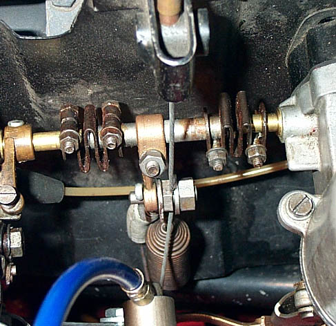

Here's mine. The thing closest to the lever that looks like a hex nut is not one; it's fixed to the shaft. The one on the right is a nut. The piece is held in place by a split pin; nothing tight. I think this may be original.
The upper fitting which holds the cable sheath has to pivot smoothly too, or the cable can fray.

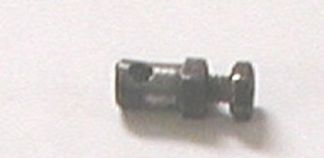

Anyone got two of these they can spare? This is what I am looking for.

George Zeck
Jim -
I know this sounds crazy - try a bicycle shop. They use these cables for bike brakes. If not there, a HOG shop would also have something.
Geo
Jim_Gruber
Jim_Gruber
George,
That was what I was planning on. Cable crapped out and was binding but what you can't see is a crack on the cable terminating clamp that was binding up. I replaced with a bike cable from Wally-World temporarily yesterday, 4 cables for $4.56 wow, but I can already tell after < 20 miles of driving that the cable from Wally-World is binding and action is eratic under foot, acceleration is not smooth and linear but jerky. Gonna make a run to the Post Office to mail taxes and a bike shop is on the way.
That looks like the bit for the heater control flap.

Swung by the Local LBC Shop here in Dayton today, yes I'm fortunate to have such a rarity only 10 minutes away from the house - MG Automotive in Kettering, OH, and managed to come up with one out of the misc nuts and bolts bin. Well worn, but it will work until I can find something better. Picture is exactly like what Steve Posted. Evidently the piece I was using is actually a Choke Pull Off Cable Terminating Nut.
jlaird
Jim, you will never have trouble with that peice you got from the parts bin. Good for another 40 years.
