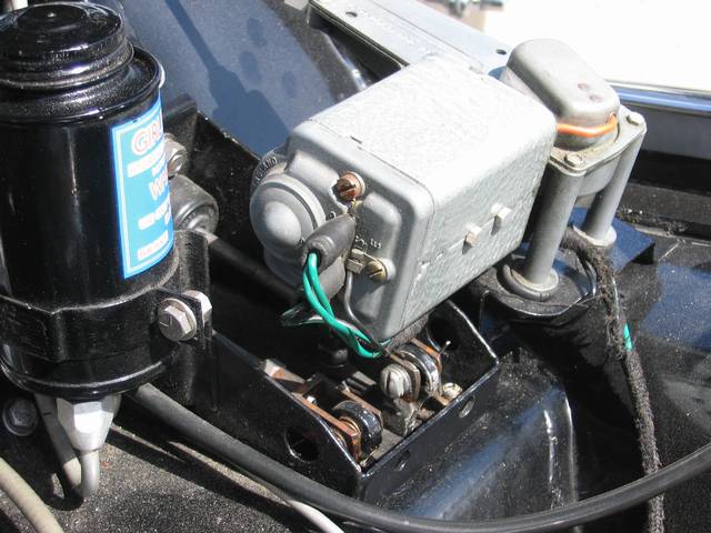

I had the problem you are discussing wherethe brake fluid peeled all the paint off. That was between 1960 and 1972. It started to happen about two years after I had bought my 1958 TR3A brand new.
I solved the problem when I restored my TR in 1990 by changing all the rubber hoses and rubber seals in the brake and clutch systems and then switching to silicone fluid. It does not attack paint. My brake reservoir area is still like it was back in 1990 with 100,000 miles driven during the last 18 summers.
