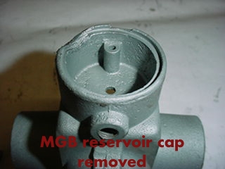

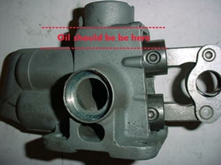

I assume on an MGB? On the front, the fill bolt is the right height. I'll try to attach a picture of what is inside that "turret". That reservoir is really for expansion, and when you add oil it will slowly work into the body of the shock. Don't try to force oil in. We sometimes get cores that have a zerk screwed in there so that the DPO can force even more oil in! (which is why we get the unit to rebuild)
A bit of history: The body of Armstrong shocks that fit the front of big Healeys, MGAs, and MGBs were identical through the first 600 cars of MGBs. After that, Armstrong added the turret bit to the top for the Bs. Sheet metal on the Healeys and A would not permit the turret structure. It is a good design feature, as it gave more room for oil (cooling) and allowed more room for expansion. To fill that area completely, negates the advantage and causes oil to weep more profusely from the shaft packings.... the only exit point. If you were to look inside at the oil level, enough to cover the piston bore of the upper piston is enough.
But again, there should be NO reason to add oil, UNLESS you notice it is leaking from the shaft. It doesn't burn or evaporate... it can only get low if it leaks. And... I have to say this... if it leaks, there is a solution.8177 oil level.JPG8177 air reservoir.JPG
