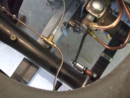

On my BN4, the links can be removed with the wheels on if the car is on a lift. The shocks will have to be removed to remove the links. The new link can be loosely attached to the shock arm, inserted into the axle mount, then attach the shock to the frame and tighten up the nuts.
The only tension on the link is the resistance in the shock arm so the axle does not have to be supported other than its natural position. But as John said I'm pretty sure the shock will have to be removed from the chassis to be able to pull the link out of the axle mounting.
