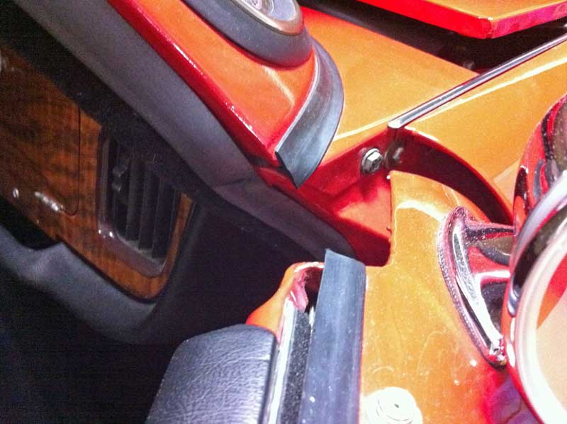

We installed our padded dash today and would like to know how far back are we suppose to trim the excess weatherstrip? Thanks

Not that difficult just time consuming. We are replacing all the dash parts and weatherstrips so everything had to be removed. If your just replacing the dash pad you may want to replace the windshield mounting gasket if it is bad. You will probably have to remove the gauges to access the metal dash mounting bolts as the dash pad slides between the top and the face of the metal dash.

Here is what mine looks like. I don't recall if I had to cut it, or if it came the correct length.
-Darrell
