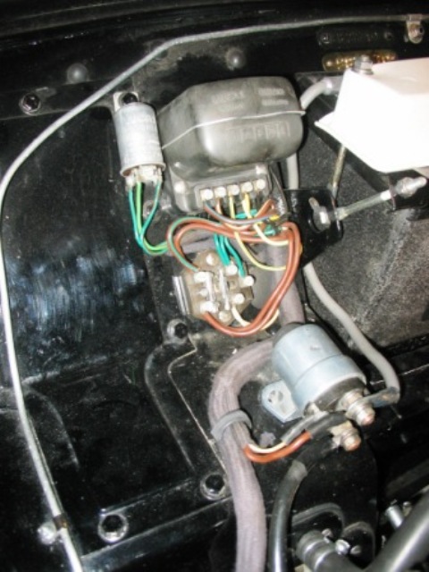

1. You don't need to run around and hop in to start it. You can push the rubber button on the starter solenoid (if your key is on in the ignition switch) and it will crank over. See photo of mine. The rubber push-button is on the rear of the body and is about 1 inch in diameter.
