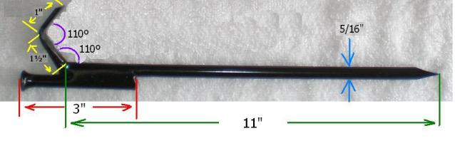

Hi Folks,
I pulled all 4 of my Disc Wheels on my TR3. I used a "Flat Hd. Screw Driver" (Yeah, I know, Not good) to pry the Hub Caps off.
There was someone on the BCF that had posted a "Drawing" of a "Hub Cap Removal Tool" that duplicated the Orig. style some time ago!
I sure would like to "Buy" that Tool & or see that Drawing & "Make" one.

Jesus
Russ,
I stored this drawing posted by some friend on one of the TR forums.
Unfortunately, I do not remember the author for giving the due credit.
Hope it helps.
Jesus

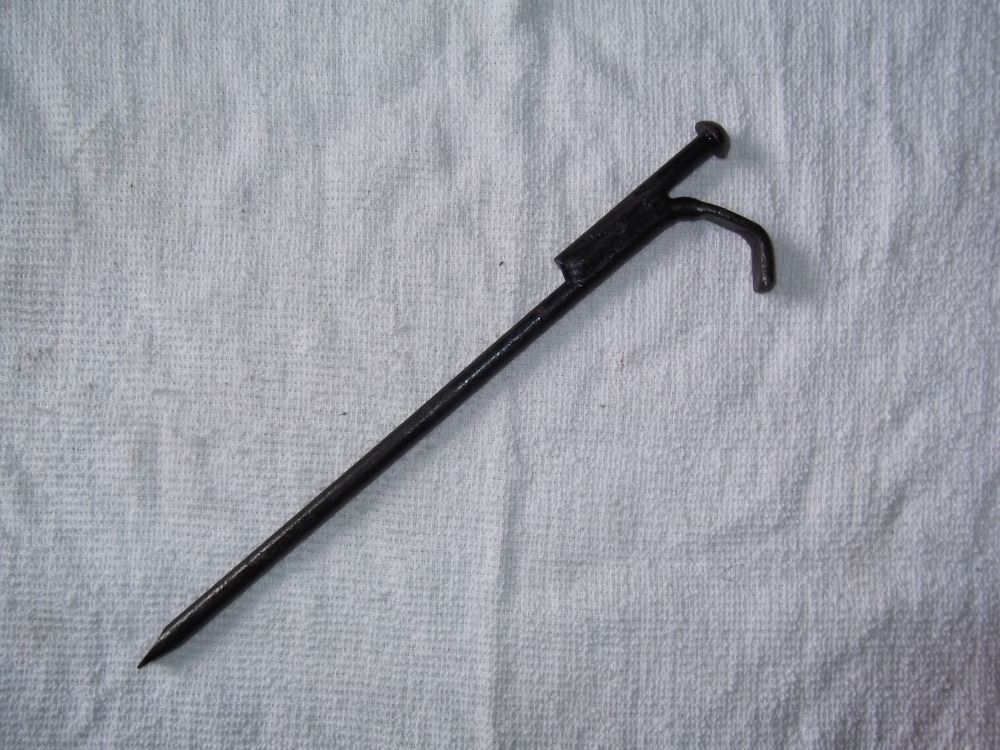

This is a hub cap removal tool. The hook goes under the cap and the mushroom presses against the wheel for leverage. The opposite end is a pry bar which can be used for removing headlight rims.
Joe
Don Elliott
Mine came new in 1958 with a "white zinc" finish. It is still in my spares tool kit for shows. It is more like the one shown on e-bay above. It does not have the extension in the photo above. Around the garage and on the road (if I need to), I use a hooked lever type screwdriver tack remover - used for pulling up carpets which are tacked down. They work perfectly.
trglory
You are correct, the one on e-bay is original, this style is the "new-and-improved' version sold by TRF. I did have what you describe, but when I disassembled the car for restoration, it went missing .... it will turn up sooner or later.
Joe

Russ,
Hope it helps.
Jesus
Hi There Jesus,
Thats exactly the dwg I`ve asked about. "Thanx Very Much"!! I too now have it saved in my computer.
"Thanx" to All for all the great suggestions.
Happy Motoring,
Russ

6TTR3A
I made up that drawing a few years ago thinking it was the original style. I copied it from a TRF "improved"model. I also suggested putting a dab of Slicone Seal on the mushroom tip that touches the painted wheel surface. I made one for a friend and 3-4 more that I sold on eBay. (I've got wires on mine) When I discovered it wasn't the original style, I archived it & forgot about it. It works great & looks cool but don't show it to the judges!!
