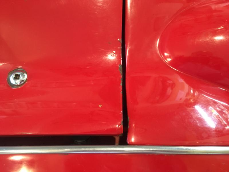

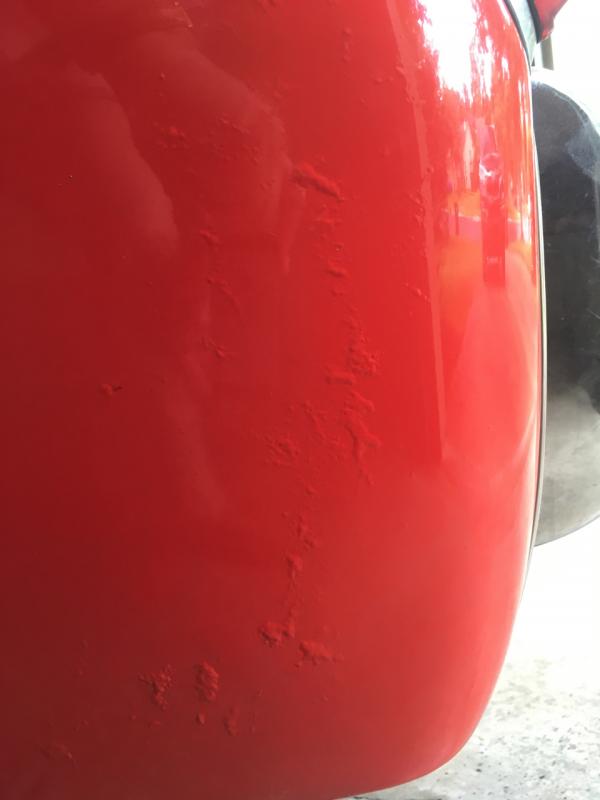

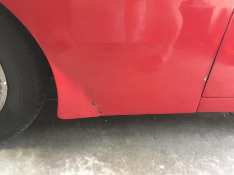

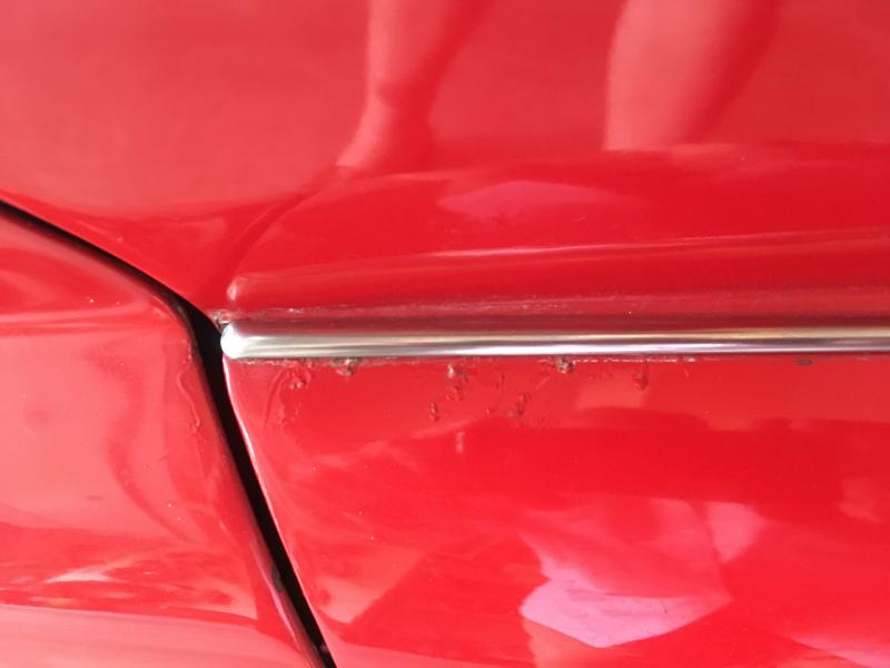

The front fenders and B posts are good. The bubbling is actually along the rear of the right front fender at the beading in front of the door and the left rear fender panel behind the wheel well. Photo one is the left rear fender; photo two is the front of the bonnet/hood where it meets the apron; photo three is the bent left front fender and; photo four is the bubbling along the top rear of the right front fender.
I'd like to be able to correct the items in a discreet/distinct manner, but as John (CJD) suggests, it's probably better to do respray of all the external panels. We shall see.
