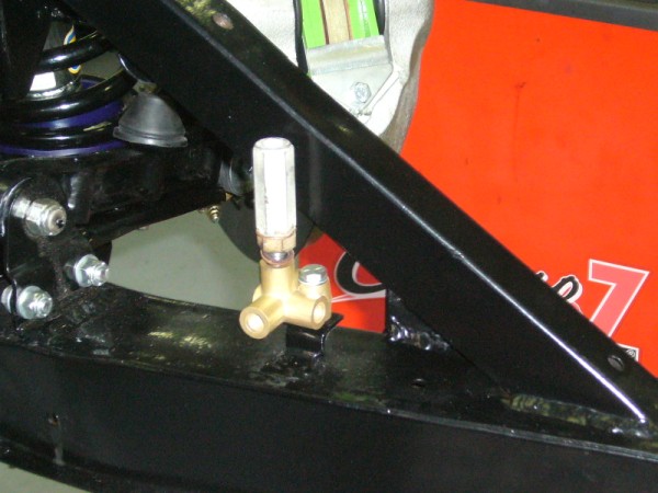

So, the restrictor valve is now empty of its innards, very clean, using brake cleaner. It has been deftly attached to the five way connector, equally cleaned, by the way. My question is where does it go and or attach to? I found the mounting point for the 3 way connector, but not the five way. Any help would be gratefully welcomed. A picture or two would be even greater.

Menno in The Netherlands sent me this a while ago when he was restoring his TR3A. It goes on the right side near the front wheel with the hydraulic brake switch facing towards the front of the TR.

Seriously, Don the pic you provided was way better than mine in every way... we're just jealous.

Actually, both pictures helped tremendously. I could see actual lines in Geos picture and the picture Don sent gave a very clear picture of the mounting. I would hate to try to install it with the body on!

Actually not hard to do with the body in place. You just remove the RF road wheel and there is pretty good access (in case you change your mind later).
