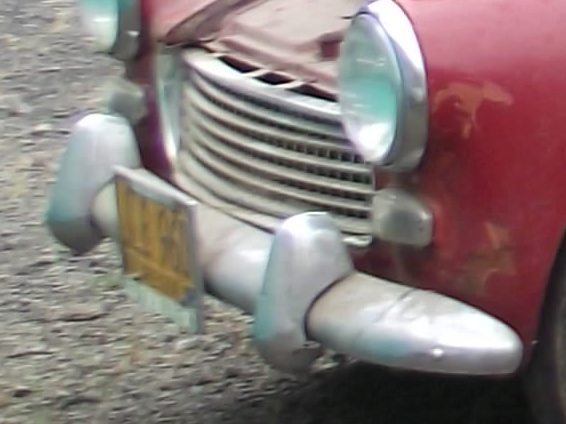

This is the sort of damage I'm looking at. The owner before us did some really poor work after some sort of collision and ignored the bumpers.

chad
look on ebay right now, there are a couple of nos bumers.
I had same choice to make a short time ago, and decided i would be sad if i went with reproductions from moss or vb, so i had my originals redone, and have never had a second thought about it. I too paid around 500 to have both done with all 4 overriders done also.
RickB
My little red Sprite came with a repro front bumper.
It was shiny, but apparent that it was inferior when placed next to my original fat bumper. I pulled the fat bumper, overriders and nerf bar off my MK1 Midget parts car and bolted them on the Sprite.
What they lack in the shiny department is more than made up in the beefy original equipment department.

Millrat
What they lack in the shiny department is more than made up in the beefy original equipment department. [/quote]
So maybe I just clean them up and put them on? They really don't look that bad on the car as it used to be but it will be a lot prettier when it comes home:smile:
nomad
[/quote]
If you want a good chrome shop to redo them you will be amazed at what they can fix. I've had bumpers that looked close to prezel come out looking like new. Caved in overiders the same.
