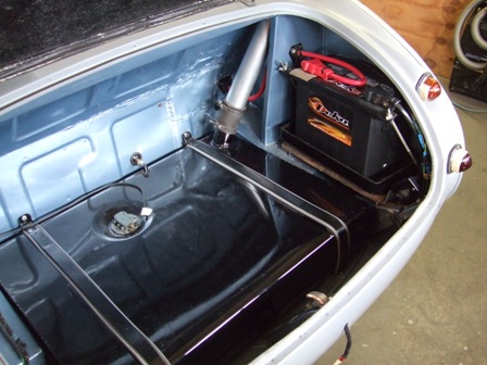

Bye the way Captain, was the new tank painted when you received it? I should have put a new one in when I put the car together 2 years ago but I thought I could save mine. I wasted good time making it look real purdy and everything. Painted it with self-etching primer then base/clear gloss black. Now I suppose I'll have to redo everything again. here's a pic of the current one. Ya know giving this some thought, seein's as how my current tank wasn't really that bad, then I decided to get anal and really do it up right so I coated the inside with that Really Good gas tank sealer and of coarse it is peeling. I'm kinda thinking that if I would have just let the tank alone it might have been alright. Dave.

First post here. Vette your existing tank looks fantastic. there must be some stuff available to strip the sealant out of it.
Acetone would probably dissolve it.
BTW, I cleaned and sealed mine with the Moss stuff in about 1999. It's still fine, but you guys are worrying me.
