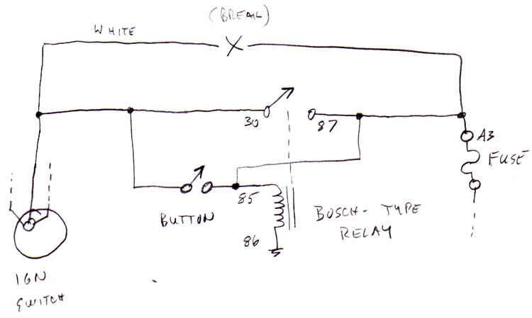

I'm looking for a switch (or some form of relay) that would be normally 'off' but when switched to 'on' (and with voltage being provided to one side),it would stay 'on' until the voltage to the circuit was switched 'off'.
The concept would be to put the switch into the distributor circuit (per Nelson/Gerard). The switch is normally open. You turn on your key and energize one side and then (need two hands!) hold the switch/button/whatever down while turning the starter over. Turn the ignition off later, and the switch goes back to 'open'.
I'm both lazy and dumb, so looking for something fail safe, where I won't have to remember to turn my 'secret switch' off each time I turn the ignition off.
Any suggestions/ideas? I seem to recall seeing such a switch in instrumentation, years ago.
Thanks
Doug
Sarastro
I think that you're describing what we electrogeeks call a "latch." Attached is one way to implement it. The idea is that you cut the white wire from the ignition switch to the fuse and insert this circuit.
You could also put this into the white wire from the fuse to the ignition coil, if you wanted it to affect just the ignition. Might confuse a thief even more that way.
When the ignition is turned on, nothing happens. Then, when you push the button, the relay coil is energized and closes the relay's switch. This applies power to the car's electrical components, but it also creates a path that keeps the relay coil powered when you release the pushbutton, so everything stays powered. When you turn off the ignition, the relay coil is no longer energized (nor is anything else) so it all goes off.
The button should be fairly husky--I'd make sure it is rated at at least 5 amps DC. It carries the full current of the switched circuits for a fraction of a second until the relay closes. You could get around this problem by putting a large diode (like a 1N4004) in place of the wire from pin 87 to 85 of the relay, but that's starting to get complicated.
Of course, I haven't tried this, but it should work. I might have overlooked something, but if I have, and it doesn't work, you're out only $5 for a relay, a button, and some wire.
