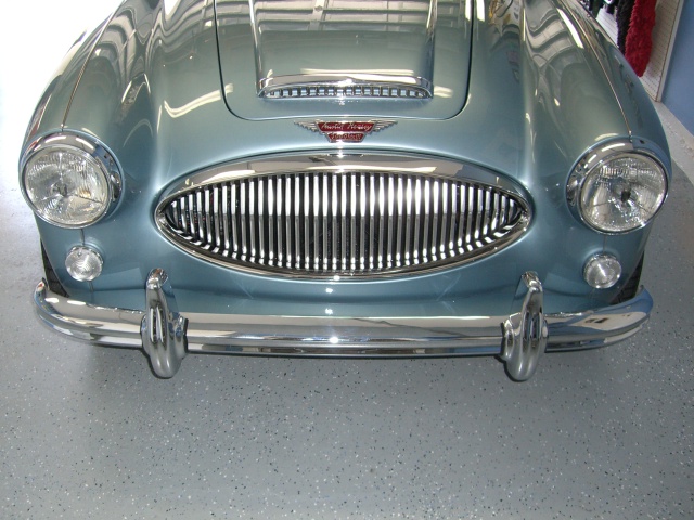

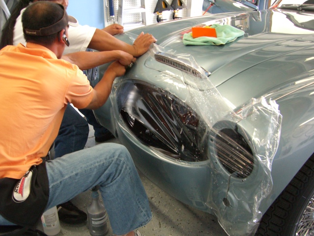

Lin, right you are. I had 4 film guys look at doing the front of my Healey. 3 of them said because of the curves, they would have to make a couple cut lines. One guy said, he does a lot of Porsches and the Healey will make the Porsche seem easy. He said he could do it without any cut lines where the curves are. He also said, if I remove all the chrome, he'll wrap all the edges too. Only see the one edge where we decide how high up the front we go. He brought a helper. 2 guys, 8hrs to do the front of the Healey. I'll include some photos of the install. One photo if you can enlarge it, may show the stop line of the film near the right headlight. This was done about 10 years ago. No yellowing, the edge line is still intact, not lifting, no dirt, looks like it has not aged at all. Can be polished and waxed. Just be carefull whenever your near the film edge and it'll be fine.
