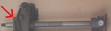

I bought a pair of swing axles and could not separate so I had my mechanic take care of disassembly and reassembly. I now find out the new axles were the wrong ones and have to do this all over again. Since this was recently assembled I figure I would save the money and do it myself but I’m running into and issue. I don’t want to damage the new bearings so I thought I better ask before I continue. I was able to remove the hub without much effort but the rest of the assembly is still on the axle, I tapped it a few times with a hammer to try to loosen but it hasn’t budged, is there anything that needs to be removed or is it a matter of being persistent and using a bigger hammer and eventually everything else will come off.

The shaft presses through the bearing. The best way to disassemble this would be to take it somewhere that has a press and remove the wrong shaft. While there, press the new one in. While you might be able to hammer the axles out and in, like you... I would be afraid of damaging the bearing.
