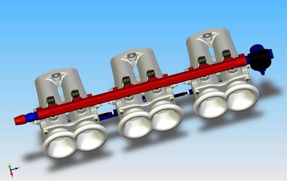

Can't fault the response, that's for sure.
Here's what they have to say (the spelling mistakes are theirs, not mine):
Basically all the engineering is done. We are awaiting the casting tooling and we have yet to make the core box.
The kit will consist of three pairs of manifolds, fuel rail, injectors, fuel pressure regulator, air horns and air box, all specifically designed to fit the TR6. It will be available with 45mm throttles.
We are expecting the price to be around $4200.00 complete and deliveries of the first production to begin in early March 2006. Attached is a JPEG view from our Solidworks CAD files

The downside to the F/I by itself is that you won't gain that much in HP/Torque for the investment. Again , most of the developed HP will usually be in the upper rpm range. It is absolutly a beautifull piece of work. Of course lots depends on the other work to compliment the added fuel & air. Even Ricks F/I SU replacement dosen't boast performance gains but reliability & driveability enhancements.
If it had the ability to later be adapted to a turbo or blower I would be more inclined to buy it, but it's not. Fuel injection is about efficiency & optimization. In an open throttle battle unless your carb is very poorly tuned , the results would be similar except for fuel consumption because of the infinite tuneability of F/I. Since race condtions don't apply I think the gains for street use would be mild power gains & better throttle response. You will also have to deal with re-mapping the timing & fuel curves with changing motor designs and power adders.
I'm not bad mouthing the product , only saying everything must be considered before diving in. It's alot of money to invest & not get the results you expected.
