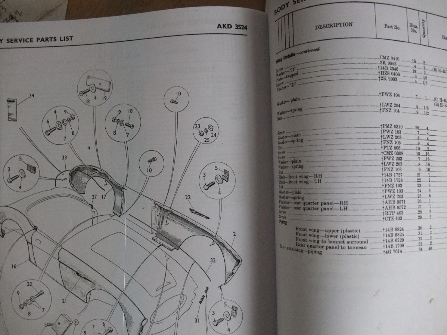

Above is from the body parts list, plate C1 page BC3. Part 19 is shown as a threaded plate. I can't find one. Is this relevant to BJ8 as the book deals with both BJ7 and 8? What is it?
Cheers AJK
Cheers AJK
Probably applies to all big Healeys, as our BN2 has them. Whereas the rest of the wing is fitted with the (sort of) sheet metal screws and tinnerman-type nuts (parts 3-5), the very front of the wing at top is secured with the threaded plate and a bolt (note also parts#6-9, which is a regular bolt and nut). The plate acts like a large nut, sandwiching the flange of the wing against the frame (the other type of bolts/tinnermans secure the wing to the shroud). You could fab them yourself; IIRC the bolt is 1/4 inch by one inch, and the tapped hole is offset a bit from center. The plate itself is about one inch by 3 inches (sorry don't have exact measurements). I would fit them.
