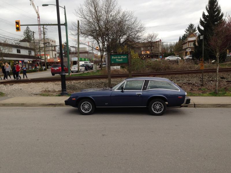

I have a GT,the lesser known version,same mechanicals,nicer dash and way more Wow!factor
attachment.php
Cheers,John
JPSmit
Love that! there was one for sale close by here a couple years ago!
