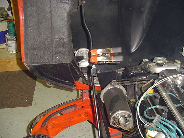

I was putting the radiator shroud back on my GT6 last night and once again (this has happened about 4 times over the years)I bumped into the bonnet stay rod and the bonnet came down on me. It caught my arm between the bonnet and the front valance, and banged my head. I don't know if anyone else has had this problem, or come up with a solution, but I ended up putting two spring clamps on the stay rod joint. I tried hitting the stay rod, and now it would take quite a bit of pressure to move it.
So with a sore arm and a bump on the head, I hope this prevents any more accidents.

I'm glad to hear you're okay. I wouldn't be surprised if someone, somewhere, has been killed by that damned bonnet falling! All it takes is a little nudge, and BOOM! /bcforum/images/%%GRAEMLIN_URL%%/mad.gif
Although I don't like the looks of them, and they're not original, I think the gas strut mod for the bonnet on Spits, GT6s, Heralds, etc., is a very wise safety mod. I did it to both of my GT6s and never regretted it.
That bonnet falling could really hurt you. It's happed to me and probably just about everyone else who's worked on these cars enough.
Gas strut mod: A good thing IMHO.

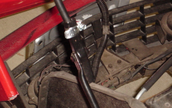

I use a bungie-cord from the bonnet stay to the frame.

My stay rods have all been well over center, so it takes a good bit more than a nudge to drop the bonnet.
You could easily put a slip tube down the upper shaft to lock the two pieces together when the bonnet is up.

Like everyone else here, been there and done that. I use the clamps as well, keep them in the spit and will soon be in the gt6 too.... That's one lesson I don't want to relearn...

Foxtrapper, I really like the idea of a slip tube. Perhaps a piece of conduit with some old radiator hose or similar stuffed inside to keep it from rattling when not in use. Thanks for the idea.
(Oh... I like the clamp idea too. However, I know that when I next need to remember the clamps I'll either forget, or be to lazy to hunt them down).
