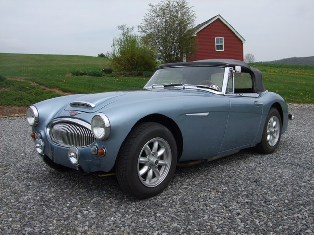

I was wondering if you might be talking about the one like I have here. They work well enough as I am using them but I have two disappointments in them. One is as you I think hit on is that if you want to use them as a horizontal rectangular configuration then they can not be adjusted inboard enough to be useable. A very poor design deficiency in my opinion. As the picture shows I had to turn them to a vertical configuration to make them useable. That's not what I intended when I bought them. The other negative to these mirrors is that they must be attached to the glass of the quarter vent windows and they are so tight in the glass to frame gap that the quarter vent windows can not be opened with these mirrors installed. Also, if the quarter vent window was opened then the mirrors would swing out with it and the mirror would be useless. but for now they do give some rearward utility until I decide on something better. I bought mine through Moss.

Our experience mostly matches yours, but I can open/close the vent windows. And I'm with you: maybe not perfect, but they do provide some rearward utility.
You've got a dang good looking car there! Doug
