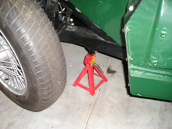

Right now my car is on jack stands at not quite the lowest level. I really don't care to go higher with the jack stands I feel that at the highest level they are not stable enough for me to trust my life with. I still have some work to do under the car. Fuel lines for one thing and a few other odds and ends, so I want some stability while I'm under there. A lift would be great but don't have one nor the budget for one.
My question is, what have some of you done to put your car up in the air with some stable supports?
Your thoughts greatly appreciated.
Thanks, Tinkerman

I have a set of small jack stands like those pictured.
I also have a set at least twice as large. I fell safe under the large stands, but I mainly use the smaller ones for small projects.
Emmett

I have a pair of the "6 ton" jackstands from HF that are very strong and sturdy; along with several "3 ton" sets. If the 24" maximum for the 6 tonners isn't enough, I have an additional base made of stacked 2x4 that will go under them. It held up the rear of my 25' motorhome just fine, so no worries under a relatively light TR, IMO.
Before climbing under, I grab the car and push/pull as hard as I can. If that isn't enough to make it wobble; then it's not likely to fall later.
BTW, even the "3 ton" stands from HF are sturdier than the style you show, IMO. I have a set of those, but use them only for supporting exhausts and whatnot.

I have a set of the small stands like you show and then I have another 8 larger ones kicking around.
You might want to look for a type of stand that has a bit of a "saddle" on it. I have a set that wraps around the frame more than just sitting on the frame.
