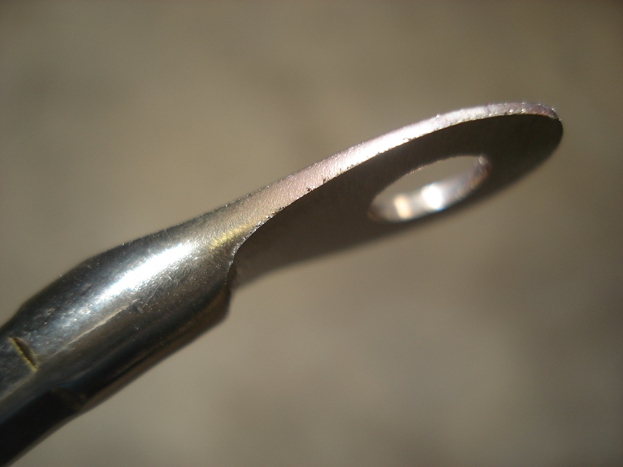

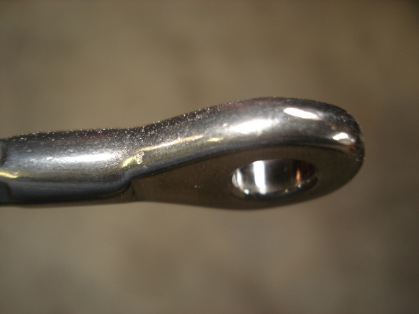

Update to this issue. I was finally able to get the cable mounted. I wasn't able to unscrew the stud any more without risk of damaging the hinge. The stud was so short I couldn't double nut it and was afraid to damage the thread by any other means. So I thinned out the eyelet using my pneumatic angle grinder with a 3m disc. Because it is solid stainless I feel it should still be strong even by thinning it down to the thickness of a washer. Besides the pictures I have seen of original cables had eyelets that were very thin like a washer anyways. Here is a picture of what I was starting with.

Here is what the cable eyelet looked like once I was done. It now goes on with the nut and I can tighten it down. The nut ends up just shy of being flush with the end of the stud. Good enough to be secure so I am happy. Thanks to all that replied and I hope this will help someone out in the future.
