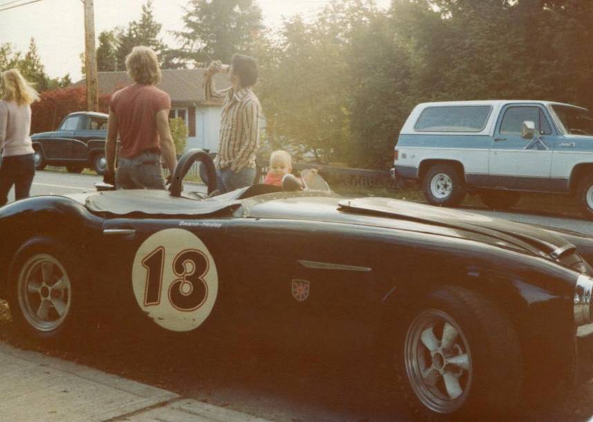

Here is the car in it's last running state. The main roll bar has been lopped off at the top of the doors and a completely separate hoop is bolted through the floor sheetmetal (!) behind the driver.
Andy.
