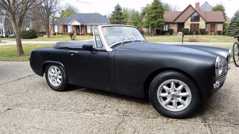

I can't go any lower with the car. I'll post a picture in a moment.
Hard to see in this picture, but the rear is pretty low and the front is about the same when measuring the sills on level ground.

Look's like a fun driver, Trevor, but your BE is the best of the Spridget's!:encouragement: All those things like a trunk you can get into and those unnecessary windy up windows are just luxury's that add weight where you don't need it!
BTW, you have good taste....great looking RB midget.

Are those 14's on there Trevor?
Nope. they are 13" minator rims. 165/70r13 tires.
