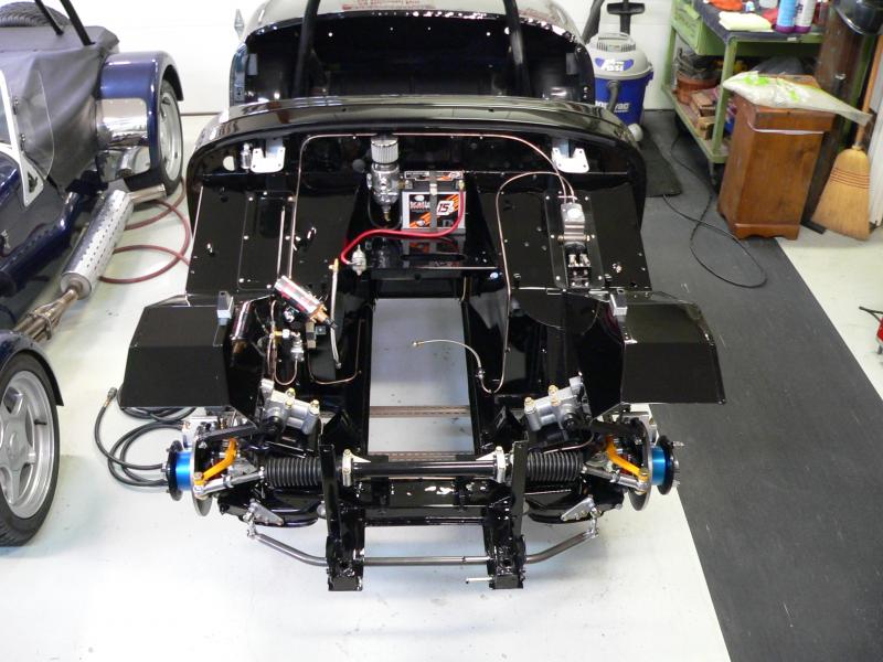

Rut, I'm still doing the shake down on the car, I only have about 60 miles on it currently. Actually, the only part that is Speedwell is the mounts and bolts, I took measurements from Gundys car and fab everything else myself similar to his Speedwell. I'm not sure what wall thickness Tom uses for his tubed 4130 7/8" OD bar. Mine is 7/8" OD with .125" wall tubing, his may be the same, Gundy wouldn't take kindly if I cut his bar to find out so I did the math.. So far I can't complain, the rear end fills very glued to the surface. I'm also using a 1/2" 4130 tubed rear bar with a .050 wall thickness.

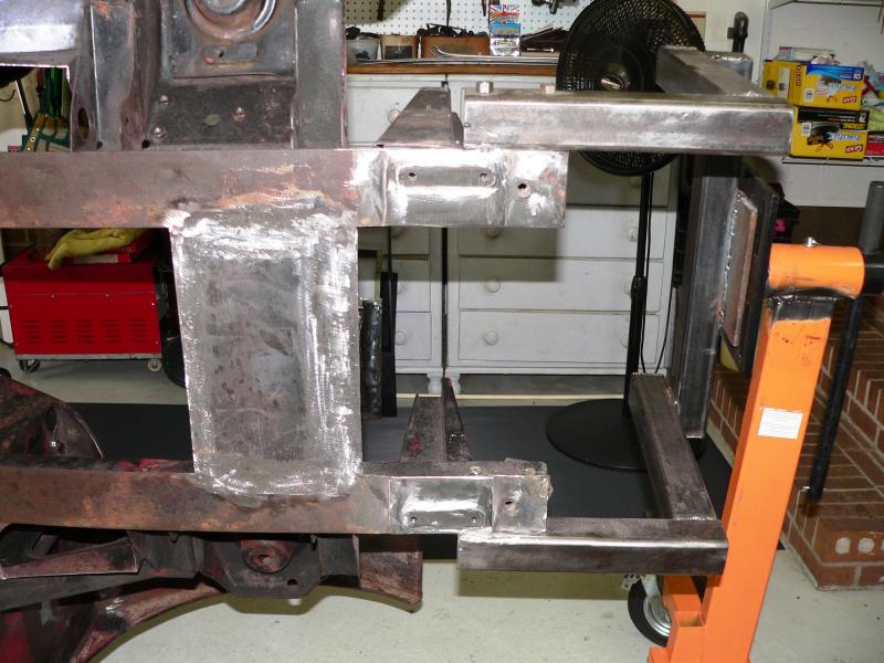

Rut, I'm also running home made frame mounts on re-enforced chassis rails. My mounts are solid moly filled polycarbonate so any flex for body roll is in the bar.

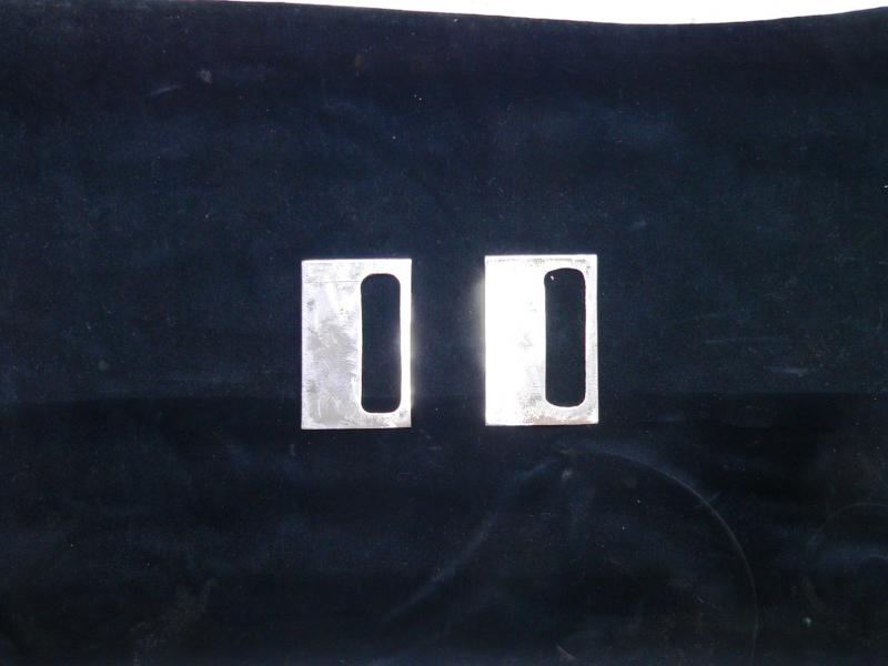

I cut a hole in a 3/16 strap for the stock mounting point to fit through and welded to that plate and the rail for a total of about 10 inch's. Pretty thin stuff and not much fun overhead welding. If a person had the car on a rotisserie that would be the ideal time to do the job. Lots of ways to do it and On my BE I waited till after the right mount failed and then bodged the job with a couple of straps on each side.
