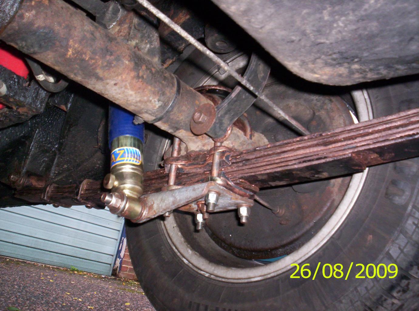

Straps should have some play when on the ground. Here's a picture of one with tube shocks:
