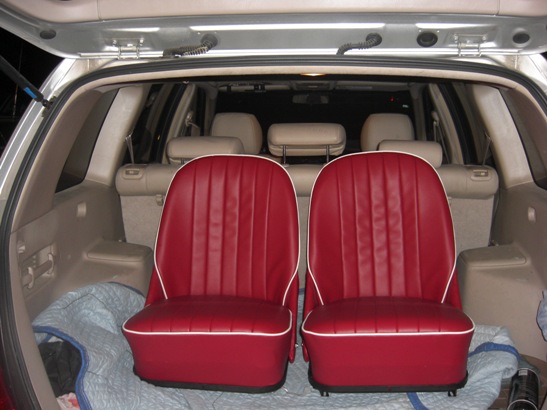

I wrapped all the metal parts that were covered with a thin upholstery batting. Helps to have two people with a heat gun. I used almost all small clips, with very few large ones. Makes sure the ribs in the back line up with the seat.
Here is a picture of mine.
Scott in CA
jlaird
And they are lovely.
