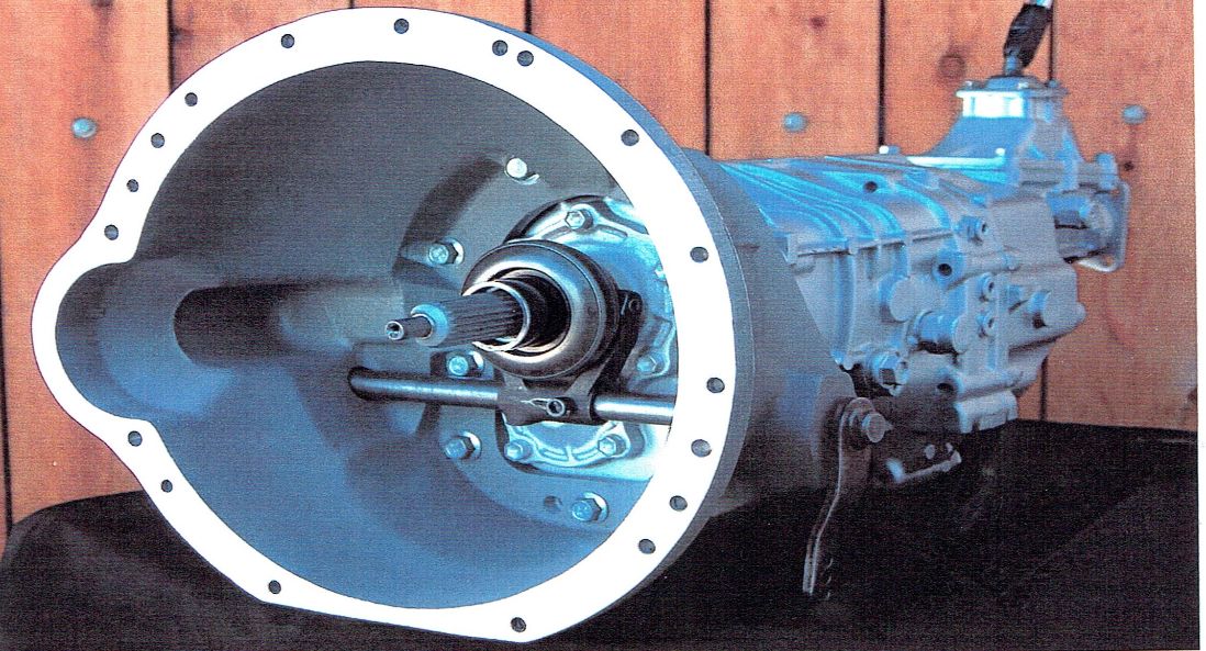

If you are quite mad, I can sell rough cast bellhousings(heat treated) for 200$ + shipping. Machine work is hard
to farm out, my W58 kit comes finished and IS made here in the USA.
Mad dog

Good to know. I have a machining source, but it sounds like a lot of work. Do you have machining specs, you would be willing to share? Also, what is cost for your W58 kit?
My machine shop has the program on their machine (proprietary ), I get them done as ordered due to the expense.
The complete kit is 2000$ and 70$ shipping. If you find a W58 ,it MUST be from a 82-85 Supra or it will NOT fit a tr6.
The shifter tower on other W58's available precludes their use(TR6), but can work in the Tr3/4
Mad dog
