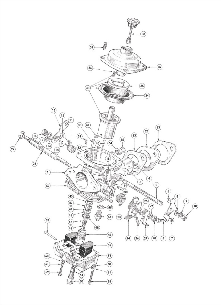

Dale no real set back, and you don't need to rebuild those carbs.
Didn't you take them apart a few weeks ago? when the gas problem started? there is a bit of crud which is stuck in the little gas valve on the bottom part of the carb. take off the bottom of the carb and clean the inlet valve again, and then put it all back together.
Part of the problem is that to many people are giving you advice, without knowing the history.... you DO NOT NEED TO REBUILD THESE CARBS JUST CLEAN OUT THE BIT OF CRUD.
Now unhook the gas line to the carb, and let it pump a few times to make sure that the NEW gas going to the carb is clean. Then clean out the intake valve on the carb, (part #54 in the attached picture) (in the bottom part of the carb, it is opened and closed by those floats (#52). Make sure that the intake valve it opening and closing smoothly and that the float goes up and down smoothly. Then put it all back together. Use the same gaskets, don't glue anything. Changes are a bit of the permetex which dissolved is in that valve holding it open right now.
