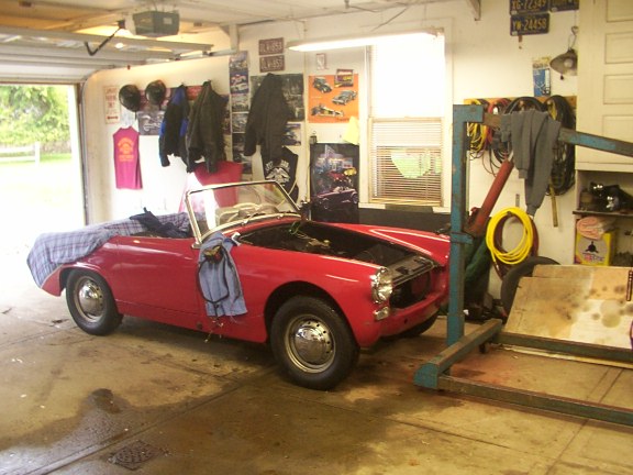

I'm a little ahead of you . Have already done the neg ground, alternatior, fuse panel,relays for lights.
Right now I am puting a Datsun 5 sp in it.
I am keeping my 1098 motor for now . It was rebuilt not to long ago. I also have a 1275 that needs rebuilt,and someday will be going into the car.. My car will be a driver this summer to . will have to try and meet up sometime.
Carl /ubbthreads/images/graemlins/cheers.gif
