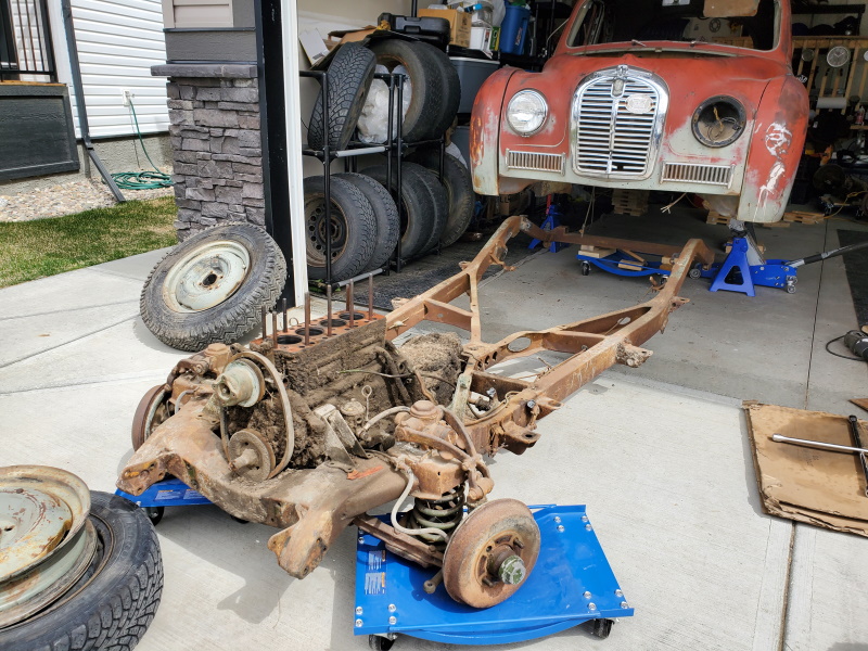

Engine wise it came with a 1.2L B-series. Not seized amazingly. Missing all the electrical bits. If anyone wants it then its free with a pickup in Alberta. :)
I have MG B front and rear suspension bought. I am swapping in the rear now. Then I bought a Toyota 20R engine to swap in. Sort of, kind of B-series like with a little more power and a 5spd box.

Rear suspension with MG B axle was tacked in place. Then I removed the frame from the body to more easily remove the engine/transmission (which is stuck together). Then finish final welding on the rear suspension.
