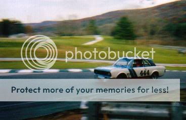

I just realized I had a few pics of our 'tina posted. The side shot is at Lime Rock and the "follow shot" is at BeaveRun (and was clipped from my on-board VHS cammcorder using a video capture card).

Nice MK2.. A friend of mine out here has a nice MK2 as well, that is only a track car ( Alan Macol). He is running with a lotus twink but it's not a locort. Nice looking car though.
