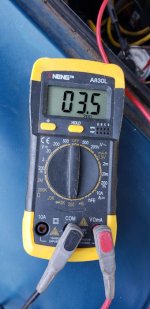

I tested ohms at the coil and found a bit over 3 ohms around 3.3 to 3.5. I have 2 coils, and both tested the same on my multimeter. I tested to the center post and found on 20k setting around 6. something so not sure what that means, but still no spark.

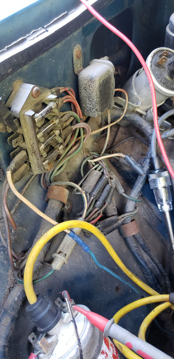

Looking at the car's wiring, at the dash there is a red and white wire that is cut, there an aftermarket red wire that is running off the red/white from the switch and running to the starter going into the engine compartment that seems to be bypassing the starter relay. disconnected the red wire and reconnected the red/white and the starter does not turn. bridged them both together and the starter turns, and the red/white wire at the starter relay under the hood will turn the starter over when attached to the lowest fuse.
There is a blue wire coming off a white wire on the fuse block off the 3rd fuse that is going under the car to the fuel pump. bypassing the internal harness wire. Thats no big deal. I can work on that later. fuel pump clicks on and is one of those aftermarket square gold colored ones. and boy does it make some clicking, but thats all good for now.

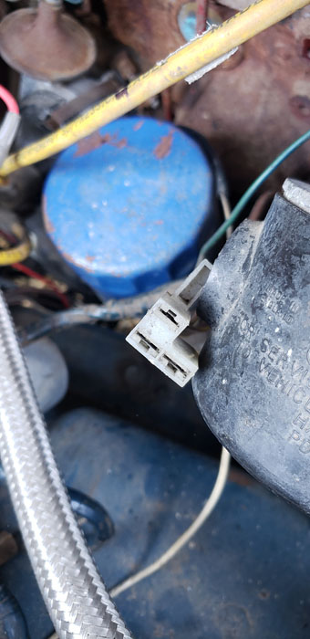

Back to the spark, still no spark found at all. Looking at the engine compartment, it looks like there is a white plug near the alternator with 3 spade connectors aligned in an L shape that is not plugged into anything. There is a wire from the car that is going from the fuse box to the alternator and there are wires on the alternator.
Coil has the white with black wire connected to the negative post on the coil and the white wire is connected on the positive post.
Towards the front of the car, on the harness, there is an area with what appears to be two green wires coming out of the harness that is cut. not sure if this is supposed to be fused or joined together, but thats not a big deal for now. This car will need some wiring fixed.
Pulled the tach, both white wires are connected at the tach. bypassed the tach, still no spark. Reconnected the tach back together.

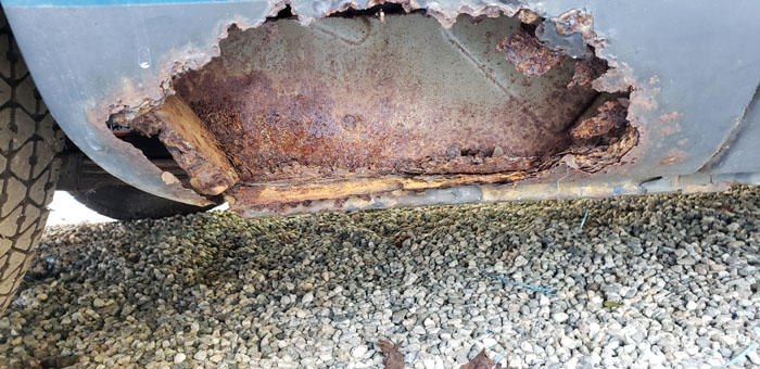

RUST:
ITs not as bad as it seems. Yes there is a hole on both rear quarter panels and on the front passenger lower fender at the bottom. but the castle rails are solid with only some surface rust. A Little Eastwood rust enscapulator for the frame rails and should be good to go. All it needs are new rear quarter doglegs to be welded in, and the front right lower fender bottom to the welded in. then the rust is clear. Floors all solid.
The dash has rust on the frame. it was expected, and its not great. so I figure thats going to have to be replaced at some point.

Would love some good pictures of the engine wiring connections and what the two green wires towards the front of the car are for.

I have yet to see if the coils are bad, but they ohm out at 3.5 on both terminals so I assumed that means they are good. one is original lucas 12v and one is a lucas sports coil. Worst case is if I test the coil and they are both bad, I'll get a coil, and a good one, either lucas original from one of the online british parts places or a bosch one as mentioned to me by someone. Definitely will not even attempt to save a few dollars to get some no name or DHK (stands for Direct from Hong Kong)(Made in China) Brand.
