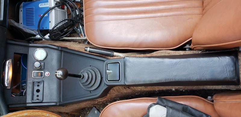

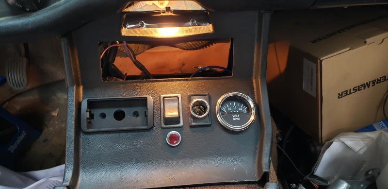

Still haven't done the brakes. yeah I know I need to.
But I did finish the center console and refinished the plastics for them. Looking great.
Will be plugging the radio hole with a blanking plate. have a bluetooth unit going into the bottom left of the console which the bracket is now mounted where the hazard switch used to be. Added volt meter to right side where cigar lighter used to be.
Love how its coming out.
