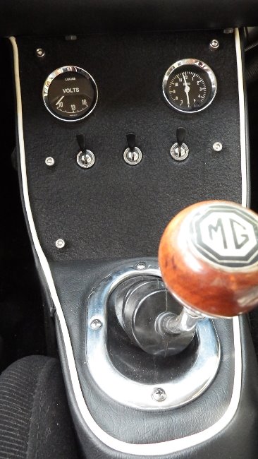

Not sure you've seen this, or even care, but Nisonger can supply a more period correct volt meter. This is the console I put together for our '64 MGB. clock also from Nisonger.

That is nice. I had seen those when I ordered my gauge, and when I ordered I got the one like I got instead because I thought my gauges were that way around.
Obviously I was wrong, but it was way too late as it had been way too long since when I ordered it. I had put it in a box in the trunk and forgot about it for like 3 months.
So too late to return it.
But thats ok, doesn't bug me. I can always get a different one later.
