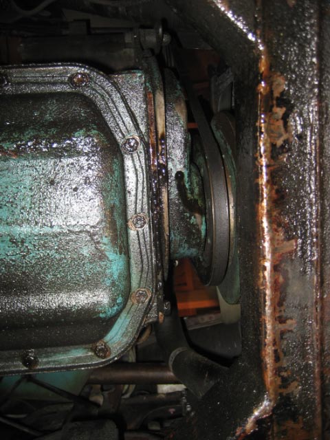

So finally found the time this afternoon to jack the car up and look for the oil leak. from the oil spot pattern on the floor I was expecting to see oil pouring out of the bellhousing of the gearbox. However whilst I was looking all around there, the oil was pouring out of the front of the engine (see attached pic which is after 5 minutes). Couldn't get under there myself for fear of getting oil in my eye, however used the camera to get a good shot. Looks like the oil is coming out between the pulley and the timing cover. So, what's the diagnosis..? How do I go about fixing it..?
Thanks for your help.
Myles

Pull radiator, hoses and belts. Remove damper/pully and replace front seal. Most cars can be done insitu, worst case remove timing cover and push out and replace.

You should look closely to be sure it's the oil seal. I thought I had a significant front oil seal leak. When I looked closer it was a loose bolt at the bottom of the timing cover. I was amazed that it leaked so much.
steveg
From the picture, you're missing the oval washers between the bolt heads and the oil pan. There are similar washers between the timing cover and the front plate.
My car leaks similarly, but less, between the timing cover and front plate. Tightening the bolts reduced the flow a little, but not much.

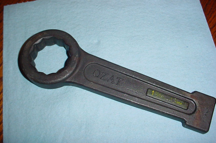

As I mentioned earlier, this wrench or the offset version will remove any nut. Much more solid than a breaker bar. Attached.
Remember when you put the nut back on it needs to be as tight as it was before removing.

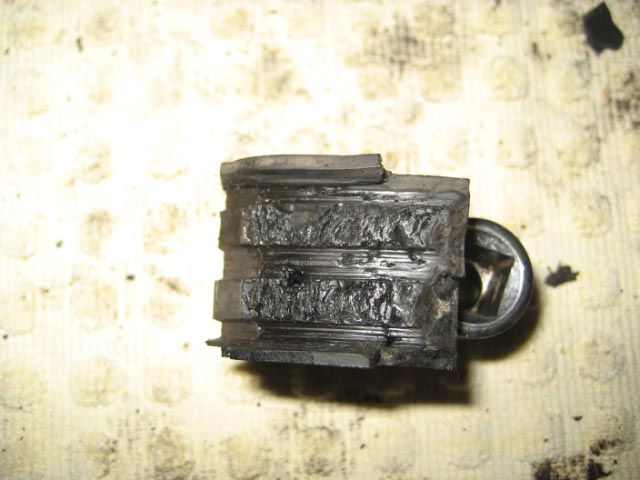

Thanks for your help with this. Car is back together and running fine, oil leaks also seem to down considerable but not taken the car for a long trip yet. Good thing I removed the timing cover in the end as this is what I found...!
