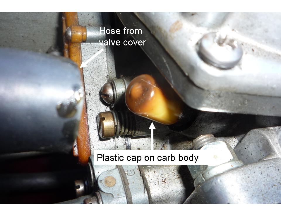

Ken... I just went outside to check the hose coming off of the valve cover.... the hose has some "T" fittings and one part of the hose goes to the carbon canister next to the radiator, but there are two more lines each connecting to the carbs. I pulled each hose off where it connects to the carb and BOTH carbs have little plastic domed covers over the carb inlet.... essentially they are blocked off. The hose's are connected to each carb, but the plastic cap is blocking the holes.
Should I remove the caps? Why are they there?

Here's photo of the caps on each carb:
How do I deal with the canister? What needs to be done?

Those really aren't "caps" per se, Elliot. They are adaptors so the hose from the valve cover will fit onto those "evacuation ports" on the carbs.
At the very least connect the valve cover vent to one of those nipples and cap (seal) the other one.. On the carb you cap, you MAY have to turn your mixture adjustment about 1/8 to 1/4 counterclockwise to compensate....but do some driving and check your spark plugs for color..no use in assuming they will need any adjustment.
If you have the cannister you could go ahead and make the connections as shown in the Moss catalog for instance.
But, having eliminated most of that emission stuff myself, I've found the set up that I show pictured to be perfectly satisfactory in relieving crankcase pressure.

Thanks for the photo Ken... that helps a lot. I'll have to get some smaller diameter hose in order to make the connection to the carb. I sure hope that stops the oil from coming up the dipstick tube. Since I don't have the felt seal on the dipstick, I'll order one tomorrow.

The purpose of the adaptor in your picture is so that the same hose will fit both the valve cover nipple and the carb, Elliot,
I get that the adapter (cap) allows the hose to fit, but since there is no hole in the cap the hose cannot vent into the carb... what am I missing?

OK, that makes sense now. I see that TRF part #155148 (AZ80) is no longer available. Can I just cut the top of the cap off of the one I have?
I'll check Moss to see if they have it.
poolboy
Make sure the hose fits tight around the cap so the carb won't be sucking air instead of from the valve cover.. You may have to use some silicone RTV for a good seal without having an "official" adaptor.
I measured the vacuum from that port a while back and it's not very much compared to manifold vacuum so the hose needs to be air tight around the adaptor.

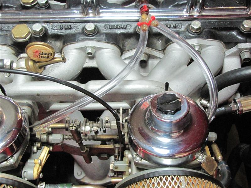

Elliot,here's how I vented my valve cover. 7/16 od x5/16 id vinyl tubing and a Y vacuum fitting to the valve cover.Triumph valve cover venting 002 (Medium).jpg

Thanks Casey... I disconnected the line running to the canister and it seems to have drastically cut down on the leak. Tomorrow I'll look into getting some fittings and do the routing of the hose's correctly.
