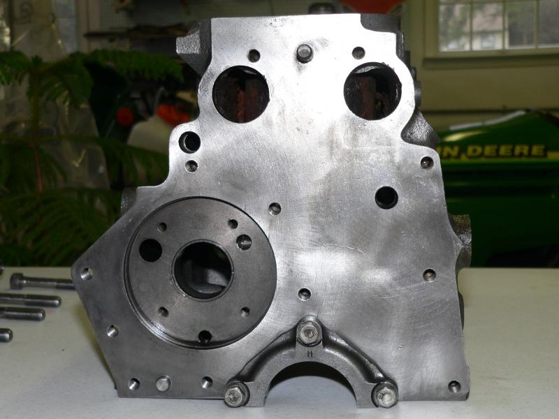

If the rear main cover shows signs of ware you can line hone block with cover in positioned to correct leakage, or install a oil seal conversion kit.

Thanks for the assistance guys. BlueMax. does your block have threaded holes for the oil galleys? I'm looking at a 948 block I have here and there is a 'freeze plug' brass cap that is covering the right side galley hole in your picture. Maybe there is a threaded plug underneath but I cannot tell. I did not rebuild my 1275. The PO did that but I've been driving it for 6-8 years without any problems. I can't imagine something going wrong with the oil galley plugs at this stage.....unless they are 'freeze plug' type seals only. I'm running about 60-70 psi in oil pressure though.

If your planning a detail rebuild having the block hot tanked? If so, then I would remove the oil galley's plugs as well freeze plugs. You will also need to have the cam bearings removed too. I would thread the galley's holes before I hot tank, after hot tanking I would bristle brush with caustic cleaner and hot water rinse. Install threaded plugs with JB Weld and you should be good to go. The photo is a 1275 block but, the cover function the same.

Yes they are threaded. This 1275 block was machined to a 1380. After boring and decking the block was impregnated and then Glyptal. Before final assembly the threaded plugs were installed.
