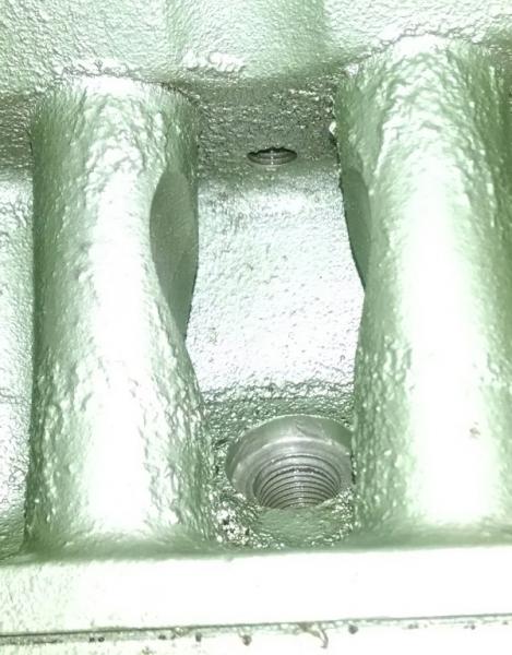

Since my engine rebuild, I've had a small oil leak adjacent to each spark plug. Couldn't figure them out because my rocker gasket wasn't leaking.
Turns out the outer rocker pedestal stud holes are tapped all the way through above the spark plugs. These studs require a thread sealant.
Thanks for posting this, Steve. I've had oil stains around a couple plugs on a freshly-rebuilt engine; I believe this solves the mystery (not worth pulling the rocker pedestals, though).
Bob - You don't have to pull the pedestals.
Double-nut and remove the studs; blow out threads with carb/brake cleaner and compressed air. Seal threads - I used Permatex Thread Sealant but pipe dope or hylomar would also work. Re-install and torque nuts to 300 lb. in. (25 lb ft). I did all 6 in around 1.5 hrs.
