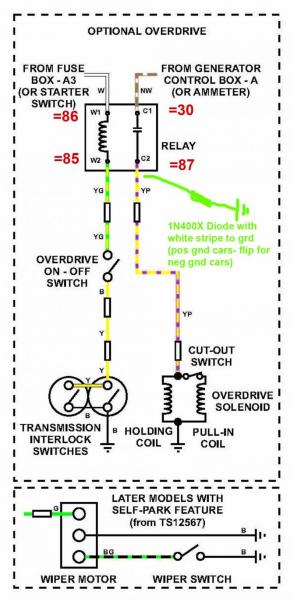

The diode will be connected between the relay output terminal and ground. Here's a typical diagram (originally supplied by Rob Michigan)
It does have to be oriented a certain way, which depends on how your battery is connected. If you look at the body of the diode, there should be a white (or silver) stripe near one end. If your car is wired negative ground (original for a 4A), the end with the stripe should connect to the relay terminal. If your car is wired positive ground (or earth if you prefer), then the end with the stripe should connect to ground.
