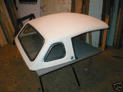

My question is about the fittment of hardtops on Triumph TR4's, TR250's and TR6's. Shortly after buying the TR4 we came across a hardtop for sale for $20. It was in very nice condition with good glass and fiberglass and only missing the bottom seal that runs along the bottom rear of the top. Being in a remote location I was not able to perform a trial fit and the owner of the top didn't know if it went to a tr4, 250 or 6. I figured if it didn't fit I'd just sell it at a later date. I got the hardtop, uncrated it, and had about 15 minutes to trial fit it before it had to be recrated and stored since we're in the middle of a move. It seemed to fit fine at the front but the back of the hard top is flat and the scuttle across the rear of the car (just in front of the trunk "boot") seems to curve slightly away. This curvature may be taken up by the missing seal but I just don't know. I know I'm getting the cart before the horse since the windshield wipers don't even work, but before I store this thing for 5 years only to find out it doesn't fit I'd like to know more about it.
So, to make a long story a quick question: Are hardtops for TR4's able to fit on TR6's or vice versa?

The top is an aftermarket top (I'm not sure how to include a picture into a post yet) and I did attach a picture to the original message. It was made by Custom hard tops of California but I can't seem to find any information about the status of that company or if anyone would know specifically what this hard top was made to fit. It is comforting to know that your hard top should fit both TR4's and 6's since that would mean that they can't be that far apart.

Sorry. I didn't see the attachment the first time. Yes, that top is very similar to mine, but in much better shape than mine!!
Please note that I can't remember who I heard it from that told me the top would fit both TR4's and TR6's. You may want to wait until someone else comes along and says the same. But, for $25 you can't go wrong either way.

Does anyone recognize the hardtop picture that I attached to the first post as a TR-4 or 6 hardtop? Or perhaps is there anyone who might be able to date the top?
