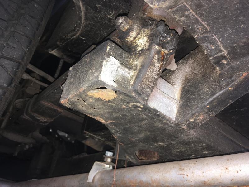

then, as the third picture shows, i found rust on the one back member. in fact it is rusted thru outside where the rear of the leaf spring attaches. everything else looked pretty good as far as i could see.

1) what is it going to take to fix that one rust area on the frame? and does that likely mean more even though i could not see or feel any.

I think I would get a screwdriver out and start poking around the frame, looks like a tip of the iceberg type of thing. Overdrive may be low on oil or have loose wiring bundle. First things to look for, if they are all right than it could be something internal. I don't know what that sender is in the block, it looks like a sender for an automatic radiator fan. My 100/6 ( long gone ) was mechanical. Owner says engine doesn't leak, maybe it's the transmission. I had that problem on my MGC and it did cause problems. I am always suspicious of decorative finishing plates in door jamb area, etc, I always think they are covering up defects and that something is being hidden. Does he have before and after photos of those plates before installation? As for cost, My opinion, a lot. Lastly, the carbs were switched out, I would want to know that every single part was included, otherwise it will be a bear to get back together. From what you write, I get the impression the re builders don't make a habit of rebuilding British engines, or they would have known how to set them up for a new rebuild.

really the rust is my biggest issue. i am not close to the car so not likely i will be back to pick more of it. what i did punch with my pick felt soild. but this does make you worry... unless this is one area that is usually the first to rust....? also wondered if there can be a cover welded over it for an easy fix. or does the whole cross member have to be replaced? and what does that involve?

3) The frames on these are a crap shoot - you can find rust anywhere, and not necessarily consistent from one car to another. The rust should be limited to the bottom of the crossmember from moisture getting in and laying on the bottom of the tube. This one looks like you might get lucky and only have to cut out & weld in a new bottom piece in that area, but you might find the whole crossmember needs to be changed.

assuming for a minute the cross member needs to be replaced. do i have to pull the body to do it? and what does that mean? seems to me i read these bodies are not bolted on like a lot of framed cars. some parts are welded... is there a site i can look at that would give me more of an idea what is involved there?

For 35-40 grand you should be able to find a Healey with a nice straight rust free chassis frame . Some see holes in the frame as not a big problem , I disagree . I see a hole to throw money in to. Fall in love with one that is sound and you won't regret it .
I'll spare you the long history of my car but I do want to mention that most of the rusted frame was on top. It was out of sight, under the floor boards. Extremely hard to see unless you have the car on a lift. The frame rusted from the inside out. It looked very solid on the sides and bottom.

Healeys are robust and straightforward mechanically. The body and structure is complex, and often structural repairs require substantial disassembly of the car. Once you are doing that, might as well do the complete job. But, if the car is generally solid and drives fine, just leave it alone.
