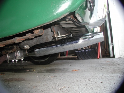

I got Bugsy's Muffler for FREE from local Harley shop. It was in their throw away pile. First thing to go on a new bike. The one you want to Bullet Shaped with a tapered tip. Will fit right in place of a stock muffler. Kelly supplied the tips on pulling in apart. I did nothing that elaborate. Center Baffle had already been punched out.A couple of adapters I tack welded to get input to 1.75". Used a hanger strap to get to approximately same size along with a giant U-Bolt to hang it from and Bob's your uncle. Search this site for Harley Muffler and you'll find Pics and lots of ideas.

muffler 002 - Harley resized.jpgMuffler 006 Resized.jpgThis is the one Kelly and I both used.

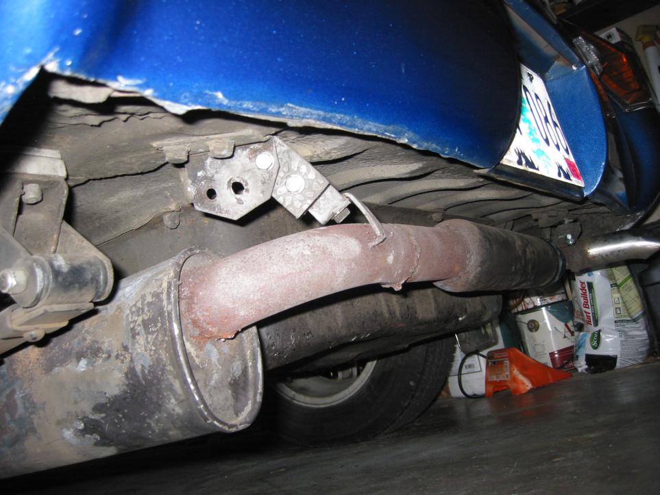

See the immage below, this is my exhaust setup.
So the resonator is the one by the rear tire?
The the larger diameter section (sitting below the license plate) right before the tailpipe tip is the muffler?
Any idea what kind of muffler this is (it is 3" in dia and about 18" long)?
Trying to figure out what I have before I work on replacing it and possibly reconfiguring it.

Doesn't look stock. The stock system had a smaller dia pipe w/ a round res first, then the muffler. Basically it was opposite of what you have.
That looks like around a 2" pipe. I'd try to cut the round thing off and just run a tip straight back right off of the muffler you have now. That is if you don't have any holes in the one you have now. You don't need both of those.
The exhaust pipe is 2" dimeter, the section right under the license plate is 3" diameter.

The section under the plate is either a glass pack muffler or a resonator. My guess is a glass pack. What size pipe do you have from the engine?
2" exhaust pipe from the engine.

Yep but that's on a 1 1/2" factory pipe. If you have a 2" pipe I wouldn't run a Harley muffler without yet another series of modifications. If you have a 2" pipe with a stock intake and carb you have more exhaust than you do intake. In that case I'd drop back down to 1 1/2" pipe w/ the Harley muffler and baffle mod. I have a 7.5 comp 1500 drawing through a single 40DCOE up front and blowin' it out a punched and modded Harley muffler. It's a straight through muffler with minimal noise. My system is about as free flow as you can get on the street w/ a stock pipe. Folks can't believe it's a straight through muffler when they hear it.

That being said, that's if you want a cruiser with max low end torque and milage but free flow as possible when you get on it. If you plan on a carb swap and want max top end power you may want to stay 2" but you'll probably need cam and head work to make full use of it.
What carb to you have and what are your plans for this car?
