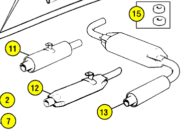

I have a lightly (?) modified 1275 in my Bugeye. I've decided that what I really need is a stock muffler. I realize that I'll be trading sound level versus back pressure, so I was wondering which of the two stock muffler systems that have been used on 1275 sprites and midgets would be best. Moss sells two - one is a single muffler (Moss #444-260, #12 in the image below) used up until Sept 1963; the other (Moss #444-270, #13 in the image) has two mufflers (or maybe one of them is a resonator). (Muffler #11 in the image is for a 948.) I think I could find a way to mount either one since there's plenty of room behind the gas tank for the second muffler.
Do any of you know which is the quietest and which has the least back pressure?

Any of the singles will still be pretty loud. If you've never heard the double (#13), they are pretty quiet. I have a brand new, never used one if you're interested. I have a Morris Minor pickup with a 1275, and with the small non-insulated cab, I had to use two muffler and a resonator to get it to a level I like.

The stock silencer (#12) is substantially quieter than the 3 things you've already tried, especially on deceleration. Thats what I use after trying all the same stuff you mentioned. Assertive without being loud. IMO YMMV etc.

Here's how I think about loudness: If it's -about- the same level as the wind/road noise when you're driving normally, obeying speed laws etc. conversation with passenger is doable...It's quiet enough.
That's all true with the single stock 1275 silencer plus the idle still sounds beefy and you don't get that glasspack bark/drone when you back off, it's just right.
As you point out, it also happens to be the path of least resistance.
