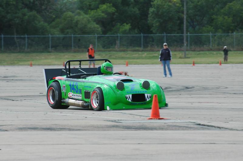

How about this:
attachment.php
I thought about dumping the exhaust just before the rear wheel on my sprite but had the same concern regarding space. Im running a 12a rotary though so squeezing a decent sized muffler under the car is not likely going to happen. Guess I will have to route it out the back of the car like everyone else.
