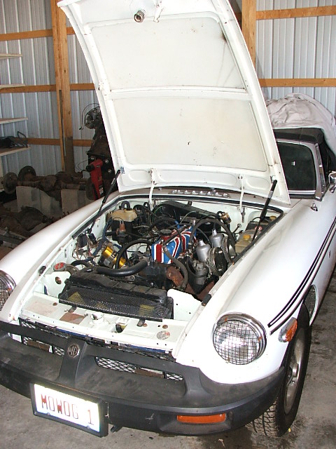

As long as you disallow anyone ELSE from "helping" you. /ubbthreads/images/graemlins/wink.gif

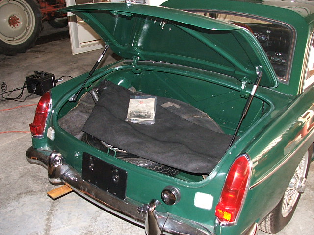

Here's the bootlid strut kit as installed on my 1968 MGC

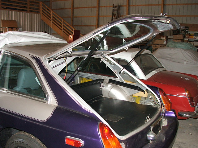

And the GT kit as installed on my 1974.5 MGB/GT

[ QUOTE ]
Contact me offlist if you are interested in gas charged struts for your MGB (steel bonnet) I also have bootlid strut kits and GT strut kits available.
https://hometown.aol.com/mowog1/myhomepage/business.html
The attached picture shows the kit installed on my 1978 MGB
[/ QUOTE ]
Wow, those all look fabulous! Hmmm ... Christmas is coming :smile:
